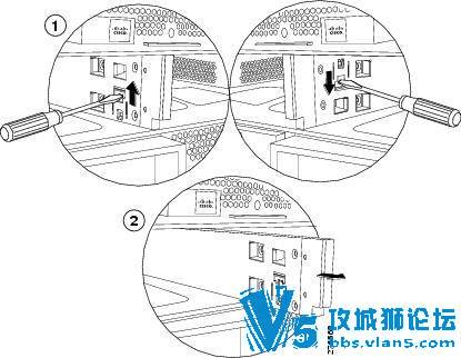

If necessary, remove the slot divider (N20-CDIVV) from the chassis.
  • Simultaneously pull up on the left side catch and push down on the right side catch as shown in callout 1 of the following figure.
  • Pull the slot divider out of the chassis as shown in callout 2 of the following figure. Keep the slot divider in case it is needed at another time.Figure 5. Removing a Slot Divider

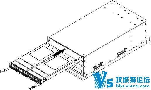

Grasp the front of the blade server and place your other hand under the blade to support it.Figure 6. Positioning a Blade Server in the Chassis" h) w1 I  Q& i: o  L+ P
: O: o" `5 B* ~8 H) B8 p5 j" F5 d 333884.jpg

Step 3
Open the ejector levers in the front of the blade server.
Step 4
Gently slide the blade into the opening until you cannot push it any farther.
Step 5
Press the ejector levers so that they catch the edge of the chassis and press the blade server all the way in.
