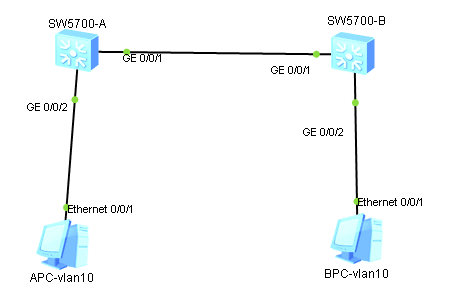

% W2 c+ i+ a+ c: B: |两台华为sw5700交换机通过trunk级联,但是不能通信,请大家帮帮忙,帮我看下哪里没有配对,万分感谢) j9 O" B3 y; n0 g
在sw1上:
. s$ n# n; A$ C- X; t! `vlan 10 8 m1 V% T% `: M8 U( M
#' e1 P# L6 o' g
interface Vlanif10
) ^; }/ U# X" s! h( eip address 192.168.10.1 255.255.255.0
% v% \7 P6 p1 f2 x2 i7 G#
! A/ z4 J7 B. H5 t, I0 Qinterface GigabitEthernet0/0/2
( K( X8 Z5 v. i. Z0 ?% x6 S+ @- Jport link-type access
' J$ _2 z4 s; L. [, i  qport default vlan 10, b! s2 X$ o, h; N1 J6 q4 Z1 ^
, N0 Q" C6 v8 R2 s; Yinterface GigabitEthernet0/0/1( V6 _, t, ]7 A& Q* O
port link trunk# [7 ^% p+ A4 c- T2 _$ N
port trunk all vlan all
8 r; Q& k3 H  u! C
* e# B; d( ^1 F3 D3 F3 Q
- f! V, e7 I4 B5 O' f4 j在SW2上:
/ z' f! j: N: _vlan 10 + m" ]( Z+ v8 {
#; O1 v( I8 n* G4 y
3 |8 x& Q4 O; S9 N- Vport link-type access2 g" X4 [- o1 P; b6 f5 U+ j4 L
port default vlan 100 d  j  \& h6 n) e0 l5 p
! L/ x/ j/ G/ Q1 W5 }interface GigabitEthernet0/0/1
+ q5 E' j1 C' M/ i$ {" oport link trunk; N5 S# y  C/ u
port trunk all vlan all( @" h  {3 j5 \: q1 f; m
6 p; A/ g7 J) E0 v9 c3 H/ R
% `6 @/ f' o) b% F. Q" p& i3 o

这个交换配置没有问题,多半是PC机上IP设置问题,是否在同个网段,
mdp [Lv10 举世无双] 发表于 2016-6-23 14:51:21 | 显示全部楼层
回复
宅男女神 [超级版主] 发表于 2016-6-23 14:51:32 | 显示全部楼层
SWA* j0 k* K) @; R1 @  Y- N9 {4 Q: a, U
interface Vlanif1' D6 F( D, f( R" V
ip address 192.168.1.1 255.255.255.0
6 |9 G1 h8 R  @7 `5 o3 j  r  wSW2
$ v  s- _- i& m+ uinterface Vlanif1
( M, B# `) [* v1 [2 s; T5 l6 M ip address 192.168.1.2 255.255.255.0; \" a0 w' |( I+ b! @
2 y  f( u( V! P* i  }3 a+ J! s
回复
张冠聪 [Lv8 技术精悍] 发表于 2016-6-23 19:16:35 | 显示全部楼层
trunk是不是已封装了dot1q?检查一下?
