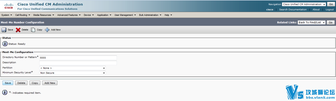

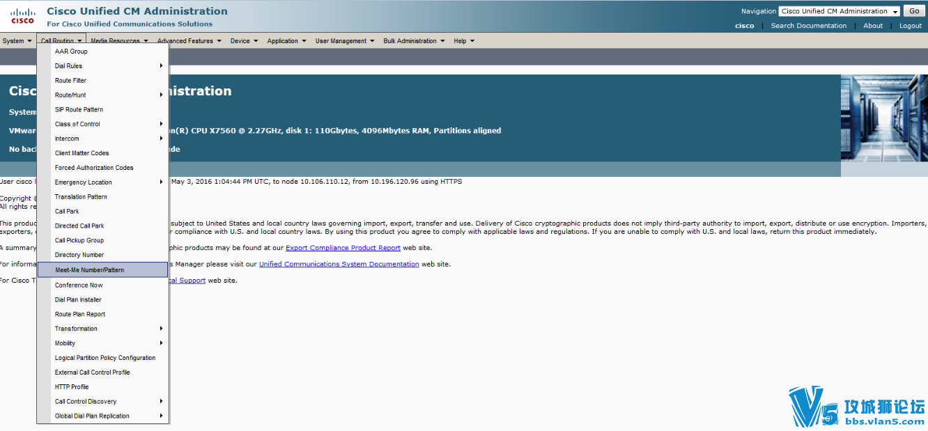

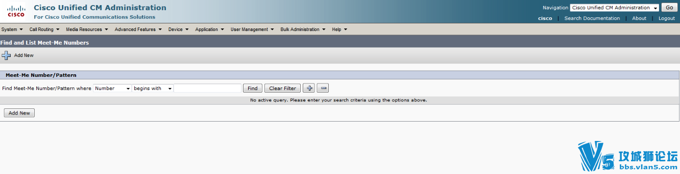

Configure
Cisco CallManager Configuration
Complete these steps:
  • Configure a directory number or a pattern.
  • Do not assign this number or group of numbers to any other IP phones, CTI ports, route points or pilot point. The number needs to be unique.
  • Click Add New, as shown in this image.
Note: CUCM Software Conference Bridge supports only G.711 a-law and G.711 u-law and does not understand any other codec such as G.729. External callers cannot be added to the conference if they use a codec other than G.711. In order for calls that originate as G.729 to be connected with phones that use G.711, you need to use a transcoder.
