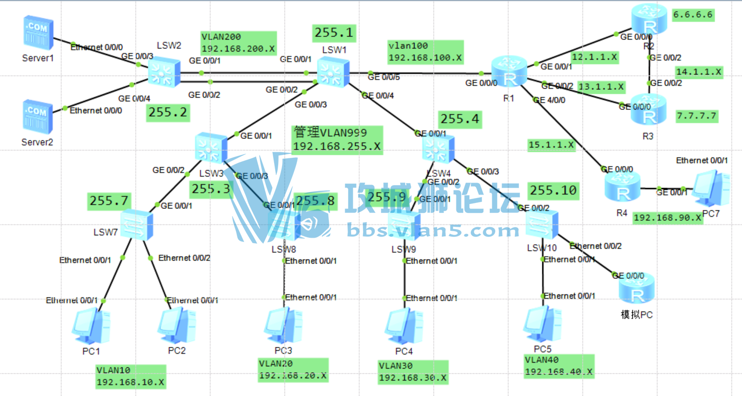

[路由交换] 小型企业组网案例Eth-Trunk OSPF ACL NAT DHCP

有错误处还请指出,万分感谢
! ^4 n$ i2 |! `/ ]/ c
拓扑图
拓扑图
# n" c5 F3 z8 W0 m" o
交换机VLAN、网关、DHCP配置( |0 i! H& E8 ^+ ?
SW1:(核心交换机)
0 z5 P/ e: F: f. D" s1 k2 M6 Gvlan batch 10 20 30 40 100 200 999 //创建VLAN5 l7 E- u) o6 l2 ?# z% Z

R1:(路由器1)
! Q, Z6 n- R, h5 `( }3 l$ Kinterface GigabitEthernet0/0/0 //接入核心交换机# E  S) ]: N5 O% ?
ip address 192.168.100.2 255.255.255.0 3 r% s/ c: B! q8 v4 o/ E* c
+ E5 z' w: x0 W$ |: L8 f5 {interface GigabitEthernet4/0/0 //接入分校区; @( x1 v6 V' g, Q
ip address 15.1.1.1 255.255.255.0 . t) p& Y, k- ]
6 [1 o3 p- S. X
R4:(分校)
4 O; w9 j! z5 D4 L7 sinterface GigabitEthernet0/0/0 //接入主校区! e* d/ A. d8 g& R9 y
ip address 15.1.1.2 255.255.255.0
& U& C' D- e, e& c' H5 N* m0 [& S#0 c' ]* S( q7 S0 E& U( R
interface GigabitEthernet0/0/1 //分校网络
" @$ A+ t; x, \& W5 `1 W0 x  H ip address 192.168.90.1 255.255.255.0
& f/ v8 ~' F0 ^4 a# n( b" r) I  P% r) P
" M" h4 R) _1 @, w
eth-trunk组建0 }' b" M$ I5 R- f! A% s. d# {3 m
SW1:(核心交换机), x0 S) T, R& I3 {1 O/ z0 V0 u+ r' Y4 }8 `
lacp priority 100 //LACP优先级为100,越低越优先* @1 P7 U0 ]$ \9 b3 y  b1 s# L" E
interface Eth-Trunk1 //创建eth-trunk 1
* H1 n3 R* L. ^( O: q' |7 jmode lacp-static //LACP模式. \+ C- o0 G8 `- Z% ?1 D5 `$ k9 Q6 b6 Z
trunkport gGigabitEthernet 0/0/1 to 0/0/2 //将接口1和2加入组
; b" k3 t; }3 D6 ^# o: Kport link-type trunk: S: V4 ?( @1 z( v$ S. O2 m
! z4 u& M' q. }; r2 q8 T- b
port trunk allow-pass vlan 200 999
* J$ t. Q$ r* h# Uundo port trunk allow-pass vlan 1 //turnk删除vlan12 M0 i  H  t' |1 L
6 |- m8 {$ Q8 SSW2:(服务器汇聚交换机)& N$ ^8 G1 n3 M7 o) L0 Z: z
lacp priority 100 //LACP优先级为100,越低越优先5 Q, D& ?& Q) P9 e1 M) [
' M& [. c6 [9 B( Wmode lacp-static //LACP模式8 x# i# C3 t7 g
6 v. y; q: B8 ?port link-type trunk
7 [2 X8 |9 l4 z9 _- R# {$ G! g( F
& {1 E/ \" h: G$ U: Wport trunk allow-pass vlan 200 999, u+ K2 ~7 M- t( ~; l% T  \* i
% g1 h9 T0 h, T2 E ip address 12.1.1.1 255.255.255.0
1 N' w4 K7 `: e2 K/ ^% [- W" r nat outbound 2000
2 X3 k' o8 i* J5 v" A //NAT出接口调用ACL2000 * z( N% H7 o$ A. {5 I
#, \$ |4 J- b- U8 {
interface GigabitEthernet0/0/2
% X/ b! ~+ ~6 g# p* {" y4 J ip address 13.1.1.1 255.255.255.0
$ f' V' I5 G! X: y; X' H nat outbound 2000
% @4 X  s% |# q2 u //NAT出接口调用ACL2000
. O- L' D( k, z( ^2 e
9 m8 a' v+ w* y5 c: s* Stelnet组建
: C6 d1 Y3 g2 z9 v2 U/ r
* n( J4 m- K( {8 OSW1:(核心交换机)1 z4 _; o8 m) c: P& o: ~
interface Vlanif9991 H# M& e; t) k  n( w  J
ip address 192.168.255.1 255.255.255.0' b3 q& I. y) O- E3 i
#9 s, c/ t3 ~$ Z8 M# `
telnet server enable //开启telent服务
6 n8 e, ~, {5 t#
7 w$ I6 `0 a/ h# W( Paaa
  v' J4 M. i3 N7 \5 c* G  e6 ulocal-user aa password cipher 123+ b. M8 h. H  g. |+ R" t. Y
local-user aa privilege level 15  //设置aa用户级别15
  U& Y/ ]7 S) tlocal-user huawei service-type telnet //设置用户可以登录telnet# e: B' z& g9 {/ m( g& L
## W) H, t, `8 @0 c2 O. E
user-interface vty 0 4 //同时满足4人登录
2 N$ n1 ~* g  Q; q( W" W0 @- Aauthentication-mode aaa //认证协议aaa4 s! H" k/ f4 [3 }7 d) W
3 F. I, [' W5 o( M+ t0 y8 f
3 k: U  P" q' q
SW2:(服务器汇聚交换机)
, }+ d( T/ J+ s9 Ointerface Vlanif9993 ]' A& n0 P& }" X% x/ a( C- N
ip address 192.168.255.2 255.255.255.0( P" V. V* }" O5 o8 R1 ~1 |3 y1 _
1 B5 P) G' g; g9 \0 ?- O6 N+ H& t) Btelnet server enable //开启telent服务
( R1 _. L  c9 X; T! \5 C#
1 v+ _; J- h' Z3 j' Qtelnet服务同核心
8 V3 u% k: M: `& L6 U( y$ X#
: h! W7 k+ q, s9 o$ m2 t# iip route-static 0.0.0.0 0 192.168.255.1 //管理VLAN回包缺省路由,下一跳核心交换机
3 n; R0 P& m/ F" ?9 T0 f
5 ~3 L7 I4 S. g7 {% j, }7 {SW3:$ C& I0 C5 i3 u
interface Vlanif999
5 {5 @% I) B" ?3 D/ D ip address 192.168.255.3 255.255.255.01 a9 `' l5 a% D! m4 p
#9 C& u3 i2 U6 F" l- }& ?3 u; E5 P
telnet服务同核心
; w! s# A) n6 l7 `: y#9 F- K0 K  B$ M
ip route-static 0.0.0.0 0 192.168.255.1 //管理VLAN回包缺省路由,下一跳核心交换机$ b" L5 X) j4 b1 a% o
0 F6 A/ O% e) L# g+ V( fSW4:* d* d  C8 V+ }
interface Vlanif999
8 w( G' l% S. g# x6 W* {; N ip address 192.168.255.4 255.255.255.03 t- d1 k. Q. z# `( @' b
#( a9 E5 o. v4 e  K  W
telnet服务同核心( o: ]/ F: R9 j" J) ~
#; S; H: g! D! S3 f# E* F
ip route-static 0.0.0.0 0 192.168.255.1 //管理VLAN回包缺省路由,下一跳核心交换机8 X) Q0 b7 d0 Q2 O7 a( C/ x
, m1 I5 A" z8 B: w& l
SW7:# c+ y7 M0 L1 g5 L
interface Vlanif999: t) i  X/ q3 G5 Z" \0 r- b3 w/ D
ip address 192.168.255.7 255.255.255.0: I) ?1 |$ f3 e) i+ R4 U+ j0 H" T
/ y; n7 }% L0 k1 L* e/ r" J+ dtelnet服务同核心
; I1 J2 R+ p- J5 O#
* ~/ \& j2 q$ e/ O$ n# Rip route-static 0.0.0.0 0 192.168.255.1 //管理VLAN回包缺省路由,下一跳核心交换机
& \9 W( B  d! w3 B4 u
! G0 e/ j! w. y( F: [# ~SW8:! u, F% s, z5 z: `% ~! \4 N
interface Vlanif9996 q/ O1 Y" g: V4 S
ip address 192.168.255.8 255.255.255.0
( U0 i2 t6 N  A% v$ u0 A! }#
1 {& @( P/ e  _+ Jteltelnet服务同核心
8 Z7 V7 P* X) d! `; p4 V8 A#
( d+ _# k* d. g6 ^ip route-static 0.0.0.0 0 192.168.255.1 //管理VLAN回包缺省路由,下一跳核心交换机
2 [6 I  S2 p6 F( S# L# ~4 a$ H- _( v8 {) e! F( e  U
SW9:0 a9 ^' f  m6 V% K1 n# @8 i
interface Vlanif999
' Y0 C5 a3 E' f/ w; j/ p ip address 192.168.255.9 255.255.255.0. M8 u: A9 f9 |) R" U7 b5 y: J
#4 Z, _- V, }3 a2 b- y8 p
telnet服务同核心
1 L* d: _1 ]1 U8 Q5 [% G#
. g+ I8 R+ m  {4 Bip route-static 0.0.0.0 0 192.168.255.1 //管理VLAN回包缺省路由,下一跳核心交换机
" m5 g4 L& ?: I5 z1 U/ J( ?+ O7 E6 }% X  }
SW10:
- N7 W. t% j. p0 m' f4 {# uinterface Vlanif999/ T# w$ a4 k3 ~5 H" O
ip address 192.168.255.10 255.255.255.04 ~4 f! ~0 @9 W" [; x7 _9 ^9 v, W4 B
$ ^  J( s1 p- b$ C  Ctelnet服务同核心
* u* N& P% ]7 k# Q; ]; h#0 R: J) E5 Z- B: f9 T
1 D: s$ d* V' l: j: q" X+ P: J, J1 d/ y2 T8 d$ [& d7 ]
ACL控制7 A$ q- U/ F6 g9 }6 W& ^
1 O7 r# Q# g' _( N
acl 3000  //启用高级ACL
, i: ]$ R3 j7 \8 W# Nrule deny ip source 192.168.30.0 0.0.0.255 destination 192.168
# U8 B/ F' z/ u* E$ P& P9 w1 @  g5 a.200.4 0
- ?6 I+ F: e! |2 y' P' g; I//拒绝源IP为192.168.30.0网段的用户到达目的为192.168.200.4
2 m/ x1 l; D6 [traffic-filter vlan 30 inbound acl 3000( {6 j; J/ D) z) _; \7 n) y
//vlan 30 入口启用 ACL 3000 规则
